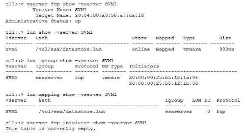

Your customer wants to access a LUN on a FAS 8300 system from a VMware ESXi server through the
FC protocol. They already created a new SVM, volume. LUN, and igroup for this purpose. The
customer reports that the server's FC HBA port Is online, but the LUN does not show up.
Referring to the exhibit, what is the reason for this problem?
  • A. The FC service has not been configured on the SVM.
  • B. The zoning on the FC switches Is Incorrect.
  • C. The LUN Is not mapped to the correct SCSI ID.
  • D. The esxserver igroup contains incorrect IQNs.

marcopubblico
1 month, 2 weeks ago
The table is empty then nothing initiators appears on LIF, the zoning on FC switches are incorrect.
The answer C is crazy tell about iSCSI in FC environment...
