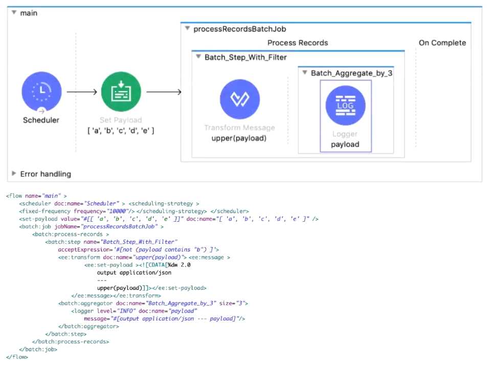

Refer to the exhibits.
The input array of strings is processed by the batch job that processes, filters, and aggregates the
values. What is the last message logged by the Logger component after the batch job completes
processing?
  • A. [ ["A", "C", "D" ], ["E"] ]
  • B. [''E'']
  • C. [''D", "E"]
  • D. [ "A", "C, "D", "E" ]

Batch aggregator value is 3. Hence in first time it will print[A, C, D]and in next iteration it will
print[ E ]
Correct answer is[ E ]
