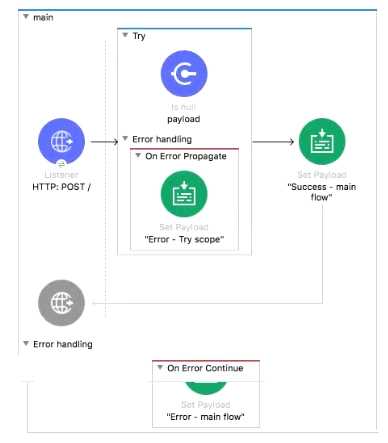

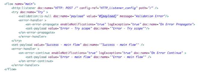

Refer to the exhibits.
The Validation component in the Try scope throws an error.
What response message is returned to a client request to the main flow's HTTP Listener?
The Validation component in the Try scope throws an error. What response message is returned to a
  • A. Success - main flow
  • B. Error - main flow
  • C. Error - Try scope
  • D. Validation Error

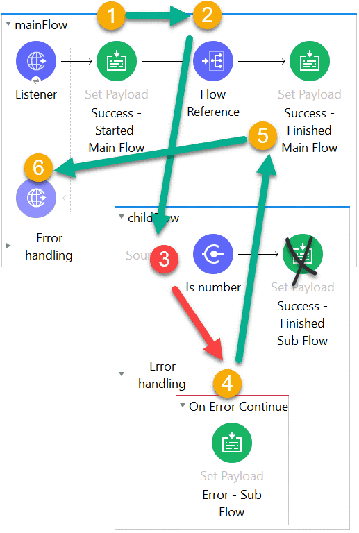

Note that private flow has error scope defined as On Error Continue . So when error occurs in private
flow , it is handled by this On Error Continue scope which sends success response back to main flow
and does not throw back an error. So main continues normally and payload is set to Success - main
flow.
Hence correct answer isSuccess - main flow
1) HTTP listener received request
2) The Flow Reference calls the child flow
3) The Is Number validator creates an Error Object because the payload isnt an integer. Child Flow
execution stops
#[error.description] = payload is not a valid INTEGER value
#[error.errorType] = VALIDATION:INVALID_NUMBER
4) The On Error Continue handles the errorThe payload is set to Error Sub Flow
5) Error Sub Flow is returned to the main flow as if the child flow was a success. The Set Payload
is executed. The payload is reset to Success Finished Main Flow
6) Success Main Flow is returned to the requestor in the body of the HTTP request. HTTP Status
Code: 200
As you can see, in the above example, because the error was caught by an On Error Continue scope
in the child flow (RED in, GREEN out) when the Mule Message returns to the parent flow, the parent
flow knows none-the-different that there was a failure because the on error continue returns a 200
success message. Note that because, to the mainFlow, the childFlow appeared to succeed, the
processing of mainFlow resumed after the flow reference.
