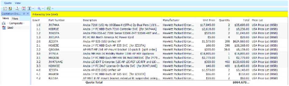

A customer needs to create a proposal for a full wireless solution for a customer The customer has
indicated that the MCs will connect to Aru&a CX Switches at the core and the APs will connect to
PoE-i- switches at the edge. The customer requires that the wireless solution support at least 50
Mbps concurrently per AP. The architect has created a BOM tor a Mobility Master (MM), two MC
721os, and 400 AP-535S. me exhibit snows this BOM.
Which components has the architect forgotten?
  • A. SFP+ transceivers tor the MC connections
  • B. Smart Rate PoE+ injectors for the APs
  • C. Mounting Kits tor the MOs and MM
  • D. Sufficient Enterprise licenses for the APs on both MCs
ccossio14
1 year, 3 months ago
50Mbps per AP on a total of 400 APs = 20Gbps of traffic to the MC, need SFP+
