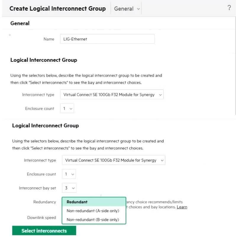

Refer to the exhibit. Your customer wants to define a Logical Interconnect Group (UG) and set the redundancy of the master modules to highly available, but this option is not available. What is a possible reason?
There are not sufficient frames for highly available setup.
Some master modules only support a redundant setup.
Firmware on the master modules is too low to support highly available setup.
A dedicated license must be added to HPE OneView to enable this feature.

There only 1 enclosure... HA config must have at least 2 enclosures. A is Correct A. There are not sufficient frames for highly available setup.
Want to join our community?
