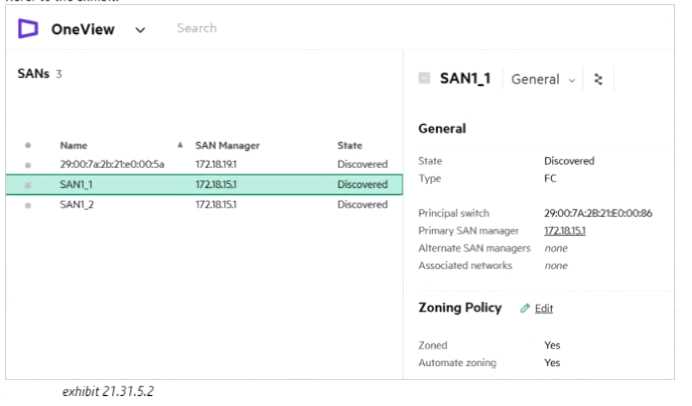

Refer to the exhibit. After adding SAN Manager to HPE OneView. you noticed that all SANs are in the discovered state. How will this affect HPE OneView storage management capabilities?
Snapshot functionality will be limited only to the volumes not using these SANs.
Volume presentation through server profile will work with the discovered state.
Auto-zoning functionality will not work until SANs are associated with networks.
Volume provisioning will only work for arrays that ate accessible through these SANs.

C is the correct option: Auto-zoning functionality will not work until SANs are associated with networks.
