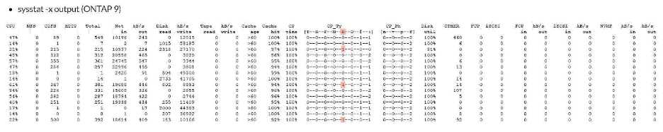

You have a 2-node NetApp FAS2750 switchless cluster with twenty-four 1.8 TB disks that is
experiencing performance issues. Upon investigation, you discover several type B consistency points.
Referring to the exhibit, which corrective action would address these consistency points?
  • A. Create additional data LIFs.
  • B. Convert the 2-node switchless cluster to a 2-node switched cluster.
  • C. Add an additional shelf of twenty-four 1.8 TB disks.
  • D. Replace the twenty-four 1.8 TB disks with twelve 4 TB disks.
C 2 votes
Dinker
6 months, 1 week ago
marcopubblico
4 days, 6 hours ago
To address the performance issues and the type B consistency points in your 2-node NetApp FAS2750 switchless cluster with twenty-four 1.8 TB disks, the corrective action you should take is:
Adding more disks to the cluster can help distribute the load and reduce the occurrence of type B consistency points, which are typically associated with high disk utilization and performance bottlenecks.
