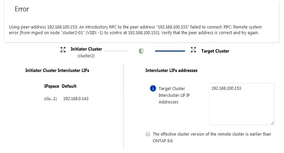

You are configuring cluster peering from cluster2 to cluster1 on your ONTAP 9.7 clusters using ONTAP
System Manager. You are given the details shown below to set up the cluster peer relationship. You
want to determine why the peering has failed.
Cluster2 intercluster LIF IP: 192.168.0.143 Subnet: 255.255.255.0 Port: e0e passphrase: netapp1234
Cluster1 intercluster LIF IP: 192.168.0.153 Subnet: 255.255.255.0 Port: e0e passphrase: netapp1234
  • A. The Source Cluster IP is incorrect.
  • B. The Target Cluster Passphrase is incorrect.
  • C. The Target Cluster IP is incorrect.
  • D. The Source Cluster Passphrase is incorrect.

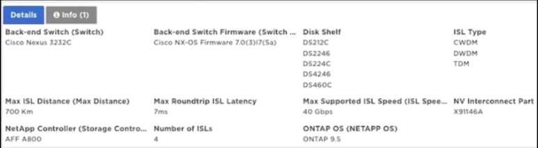

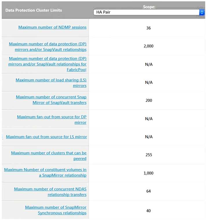

Application data needs to be replicated between two FAS9000 clusters running ONTAP 9.7 for DR
purposes only. The application has 50 data volumes to be replicated concurrently. You also require
that the application can run from the DR site should the production site suffer a disaster.
Referring to the exhibit, what would you use to satisfy the requirements?
  • A. SnapVault backups can be used to replicate all the application volumes.
  • B. Load sharing can be used to concurrently replicate the data between both systems.
  • C. SnapMirror Synchronous can be used to replicate the all the application volumes.
  • D. SnapMirror can be used to replicate all the data volumes concurrently.

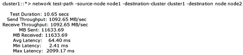

You need to verify that you have a 10 Gb path between two clusters for SnapMirror traffic. Referring
to the exhibit, how fast is the network path between the clusters?
  • A. 10 Mb
  • B. 100 Mb
  • C. 1 Gb
  • D. 10 Gb

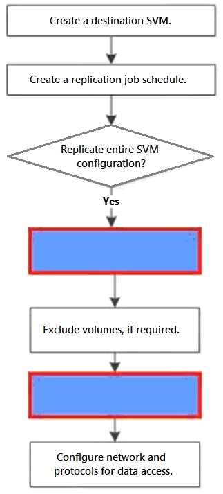

You must set up SVM replication for the first time using CLI. This replication will be used for DR
purposes. The SVM configuration does not need to be replicated at this time. In this configuration,
you will be reusing a default policy.
Referring to the exhibit, what are two missing steps from the SVM replication workflow? (Choose
  • A. Exclude specific LIFs and protocols from the replication policy.
  • B. Create a relationship with the id-preserve option set to false.
  • C. Initialize the newly created SnapMirror relationship.
  • D. Initialize the relationship with the id-preserve option set to true.

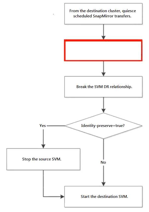

In an ONTAP environment, an SVM-DR relationship exists between your AFF A220 cluster and your
FAS2720 cluster, with identity preserve enabled. You are asked to test the disaster recovery workflow
in an upcoming maintenance window.
Referring to the exhibit, which step should be performed next to test the recovery workflow?
  • A. Delete the SVM-DR relationship.
  • B. Pause any ongoing transfers.
  • C. Abort any ongoing transfers.
  • D. Update any ongoing transfers.

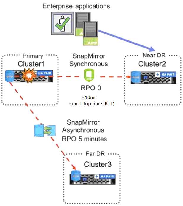

Referring to the exhibit, which three would be used to configure the three-way Data Center Disaster
Recovery topology replication schedules? (Choose three.)
  • A. Active IQ Unified Manager
  • B. Active IQ
  • C. ONTAP CLI
  • D. ONTAP Select
  • E. ONTAP System Manager
CDE
