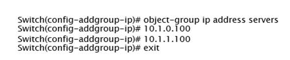

Which statement is correct regarding ACLs and TCAM usage?
  • A. Applying an ACL to a group of ports consumes the same resources as specific ACE entries
  • B. Using object groups consumes the same resources as specific ACE entries
  • C. Compression is automatically enabled for ASIC TCAMs on AOS-CX switches
  • D. Applying an ACL to a group of VLANs consumes the same resources as specific ACE entries

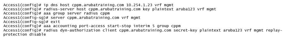

A company has implemented 802.1X authentication on AOS-CX access switches, where two
ClearPass
servers are used to implement AA
  • A. Implement replay protection for AAA messages
  • B. Define the account to implement downloadable user roles
  • C. Speed up the AAA authentication process
  • D. Define the account to implement change of authorization
Radius service tracking locates the availability of the RADIUS service configured on the switch. It
helps to minimize the waiting period for new clients in the unauth-vid (Guest Vlan) when
authentication fails because of service is not available, as well as previously authenticated clients in
unauth-vid (Guest Vlan) when re-authentication fails because service is not available during the re-
authentication period. Note that this feature is disabled by default.

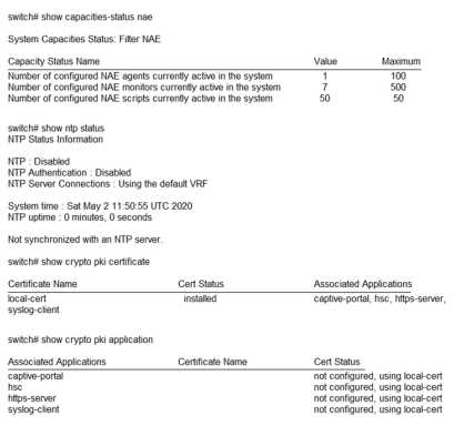

A network engineer is having a problem adding a custom-written script to an AOS-CX switch’s NAE
GUI. The script was written in Python and was successfully added on other AOS-CX switches. The
engineer examines the following items from the CLI of the switch:
What should the engineer perform to fix this issue?
  • A. Install the script’s signature before installing the new script
  • B. Ensure the engineer’s desktop and the AOS-CX switch are synchronized to the same NTP server
  • C. Enable trust settings for the AOS-CX switch’s SSL certificate
  • D. Remove a script that is no longer used before installing the new script

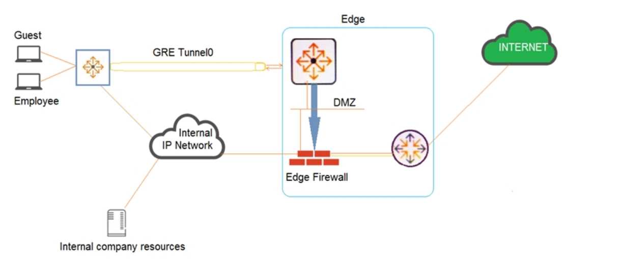

Examine the network exhibit.
A company has a guest implementation for wireless and wired access. Wireless access is
implemented
through a third-party vendor. The company is concerned about wired guest traffic traversing the
same network as the employee traffic. The network administrator has established a GRE tunnel
between AOS-CX switches where guests are connected to a routing switch in the DMZ.
Which feature should the administrator implement to ensure that the guest traffic is tunneled to the
DMZ while the employee traffic is forwarded using OSPF?
  • A. OSPF route maps using the “set metric” command
  • B. Policy-based routing (PBR)
  • C. User-based tunneling (UBT)
  • D. Classifier policies
Guest traffic can be routed with PBR to use GRE tunnels that terminate in the DMZ.
