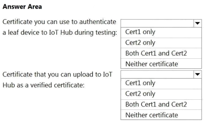

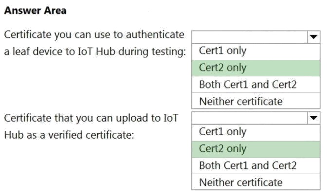

You are planning a proof of concept (POC) that will use an Azure IoT hub.
You have two self-signed client authentication certificates named Cert1 and Cert2. Cert1 has a basic constraint that contains
Subject Type=CA. Cert2 has a basic constraint that contains Subject Type=End Entity.
You need to identify which certificates to use.
What should you identify? To answer, select the appropriate options in the answer area.
Box 1: Cert2 only
Cert2: The leaf certificate, or end-entity certificate, identifies the certificate holder. It has the root certificate in its certificate
chain as well as zero or more intermediate certificates. The leaf certificate is not used to sign any other certificates. It
uniquely identifies the device to the provisioning service and is sometimes referred to as the device certificate.
Box 2: Cert1 only
Cert1: A root certificate is a self-signed X.509 certificate representing a certificate authority (CA). It is the terminus, or trust
anchor, of the certificate chain. Root certificates can be self-issued by an organization or purchased from a root certificate
authority.
https://docs.microsoft.com/en-us/azure/iot-dps/concepts-x509-attestation

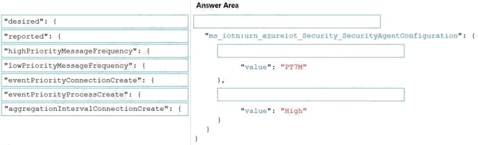

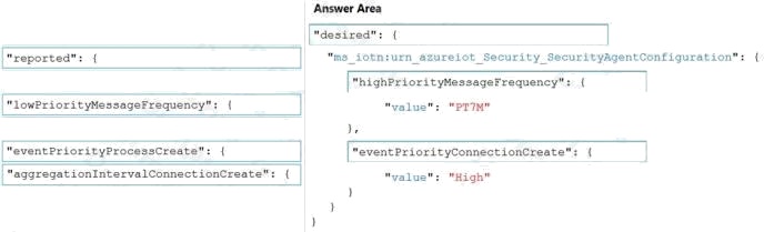

You have an Azure IoT Edge solution.
You plan to deploy an Azure Security Center for IoT security agent. You need to configure the security agent to meet the
following requirements:
Connection events must be reported as high priority.
High priority events must be collected every seven minutes.
How should you configure the azureiotsecurity module twin? To answer, drag the appropriate values to the correct locations.
Each value may be used once, more than once, or not at all. You may need to drag the split bar between panes or scroll to
view content.
Box 1: "desired": {
To configure connection events as high priority and collect high priority events every 7 minutes, use the following
configuration.
"desired": {
"ms_iotn:urn_azureiot_Security_SecurityAgentConfiguration": {
"highPriorityMessageFrequency": {
"value": "PT7M"
"eventPriorityConnectionCreate": {
"value": "High"
Box 2: "highPriorityMessageFrequency ": {
Box 3: "eventPriorityConnectionCreate": {
https://docs.microsoft.com/en-us/azure/defender-for-iot/how-to-agent-configuration

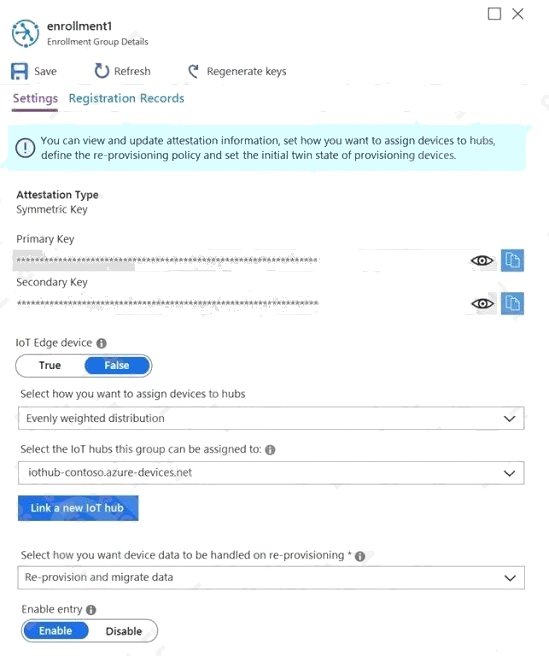

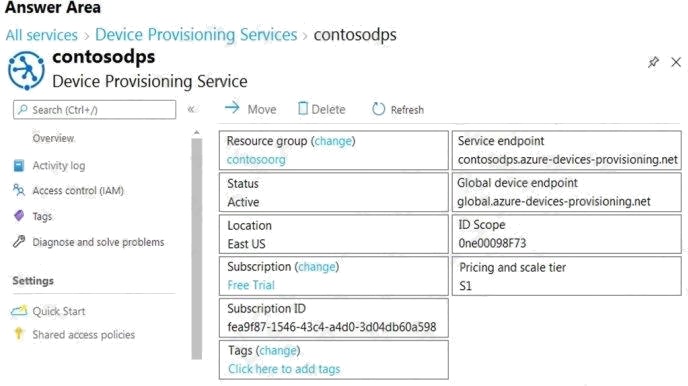

From the Device Provisioning Service, you create an enrollment as shown in the exhibit.
You need to deploy a new IoT device.
What should you use as the device identity during attestation?
  • A. a self-signed X.509 certificate
  • B. the random string of alphanumeric characters
  • C. the HMAC-SHA256 hash of the device's registration ID
  • D. the endorsement key of the device's Trusted Platform Module (TPM)
Each device uses its derived device key with your unique registration ID to perform symmetric key attestation with the
enrollment during provisioning. To generate the device key, use the key you copied from your DPS enrollment to compute an
HMAC-SHA256 of the unique registration ID for the device and convert the result into Base64 format. Reference:
https://docs.microsoft.com/en-us/azure/iot-edge/how-to-auto-provision-symmetric-keys
