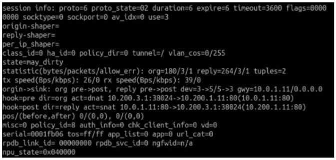

Which contains a session diagnostic output. Which statement is true about the session diagnostic
output?
  • A. The session is in SYN_SENT state.
  • B. The session is in FIN_ACK state.
  • C. The session is in FTN_WAIT state.
  • D. The session is in ESTABLISHED state.
Indicates TCP (proto=6) session in SYN_SENT state (proto=state=2)
https://kb.fortinet.com/kb/viewContent.do?externalId=FD30042

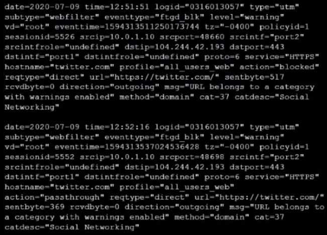

Refer to the web filter raw logs.
Based on the raw logs shown in the exhibit, which statement is correct?
  • A. Social networking web filter category is configured with the action set to authenticate.
  • B. The action on firewall policy ID 1 is set to warning.
  • C. Access to the social networking web filter category was explicitly blocked to all users.
  • D. The name of the firewall policy is all_users_web.

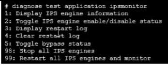

Examine the intrusion prevention system (IPS) diagnostic command.
Which statement is correct If option 5 was used with the IPS diagnostic command and the outcome
was a decrease in the CPU usage?
  • A. The IPS engine was inspecting high volume of traffic.
  • B. The IPS engine was unable to prevent an intrusion attack .
  • C. The IPS engine was blocking all traffic.
  • D. The IPS engine will continue to run in a normal state.
fortinet-fortigate-security-study-guide-for-fortios-72 page 417 If there are high-CPU use problems
caused by the IPS, you can use the diagnose test application ipsmonitor command with option 5 to
isolate where the problem might be. Option 5 enables IPS bypass mode. In this mode, the IPS engine
is still running, but it is not inspecting traffic. If the CPU use decreases after that, it usually indicates
that the volume of traffic being inspected is too high for that FortiGate model.
https://docs.fortinet.com/document/fortigate/6.2.3/cookbook/232929/troubleshooting-high-cpu-
usage

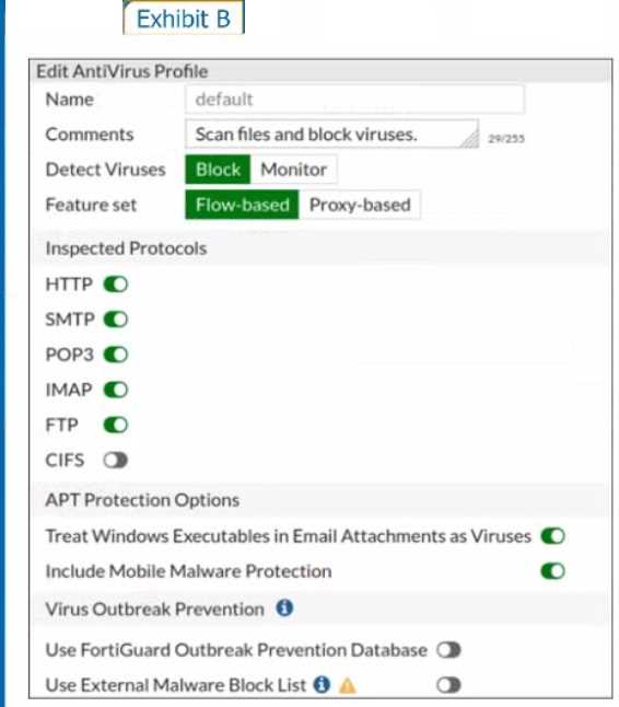

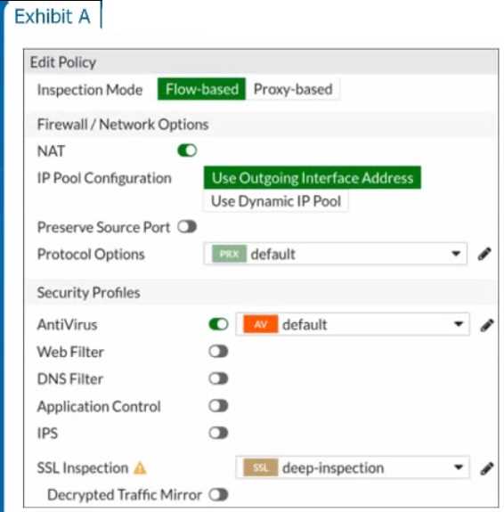

Refer to the exhibits to view the firewall policy (Exhibit A) and the antivirus profile (Exhibit B).
Which statement is correct if a user is unable to receive a block replacement message when
downloading an infected file for the first time?
  • A. The firewall policy performs the full content inspection on the file.
  • B. The flow-based inspection is used, which resets the last packet to the user.
  • C. The volume of traffic being inspected is too high for this model of FortiGate.
  • D. The intrusion prevention security profile needs to be enabled when using flow-based inspection mode.
· "ONLY" If the virus is detected at the "START" of the connection, the IPS engine sends the block
replacement message immediately
· When a virus is detected on a TCP session (FIRST TIME), but where "SOME PACKETS" have been
already forwarded to the receiver, FortiGate "resets the connection" and does not send the last
piece of the file. Although the receiver got most of the file content, the file has been truncated and
therefore, can't be opened. The IPS engine also caches the URL of the infected file, so that if a
"SECOND ATTEMPT" to transmit the file is made, the IPS engine will then send a block replacement
message to the client instead of scanning the file again.
In flow mode, the FortiGate drops the last packet killing the file. But because of that the block
replacement message cannot be displayed. If the file is attempted to download again the block
message will be shown.
